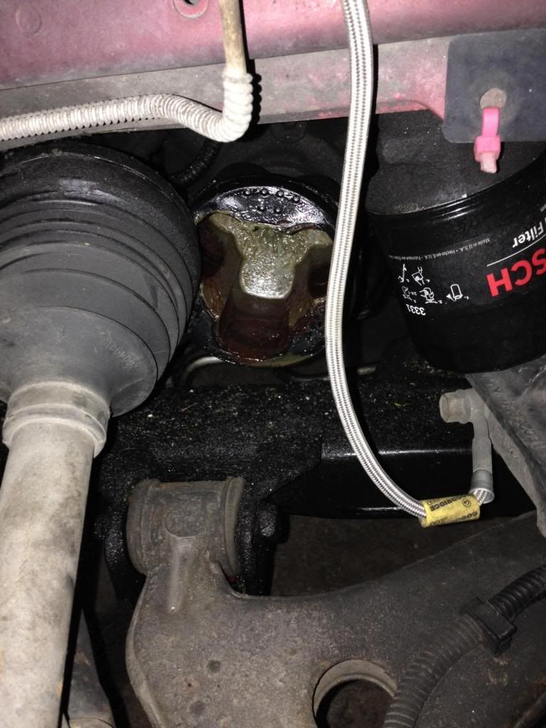

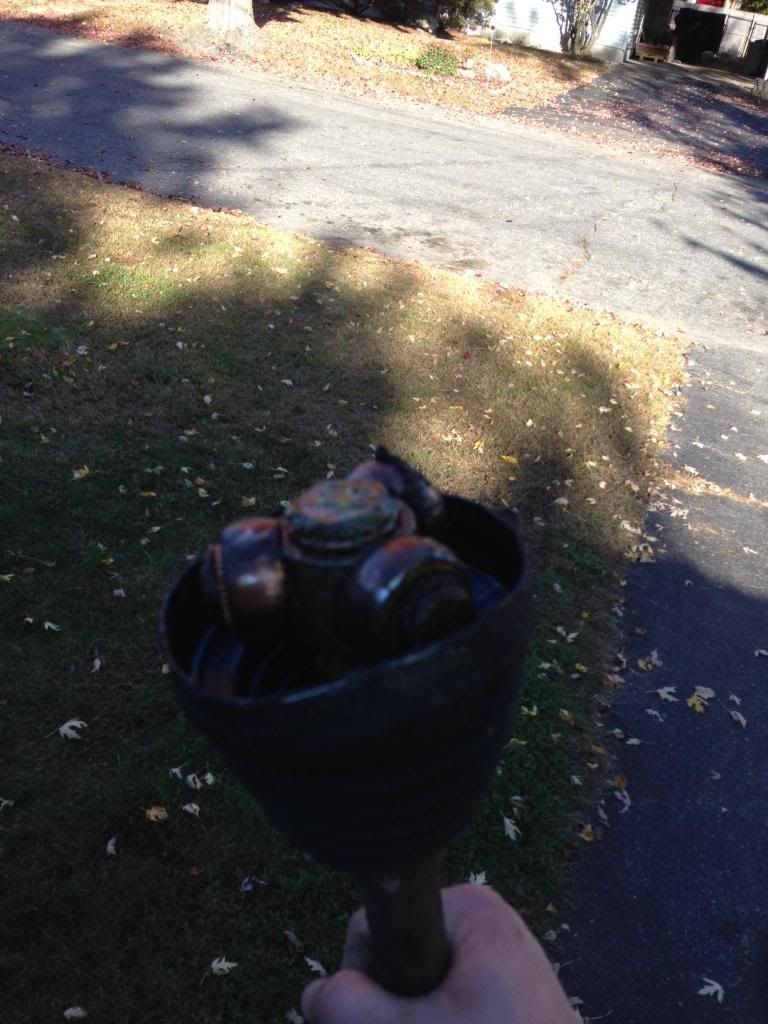

My car is shaking pretty rough under acceleration only on the highway though. So I narrowed it down to two things. First is the Axles :roll: . So I bought two brand new Axles Picture 1. The second picture you see is the inner part of the axle still in the Transmission. The inner boot completely fell apart and had very little grease that was contaminated. The passenger side was kind of a pain to get with a pry bar, but I ended up lightly tapping the back side with a small ball pin hammer and it popped right out. The third picture you see is the gears inside "or what is supposed to be sealed inside" the axle assembly. So once I replaced the passenger side I took it out for a ride before I put in the driver side axle, reason being is because it felt as though the shake was more aggressive on the passenger side then the driver side. once I let her warm up in the city I took her onto the highway and drove it normally like I do when I commute to work 70 MPH and I leave it in Drive. upon normal acceleration to keep up with traffic "1/4 to 1/2 throttle tops" I could still notice some shake, but I felt it did get better. So then I popped in the driver side axle and experienced the same problem, once I got the the top of the axle clear of the wheel hub I gave an effortless tug and the inner boot failed again. so I put the new axle in on that side and topped off the transmission fluid because I lost about a cups worth. Again I let her warm up around the city. The car seemed to drive fine, I took it on the highway got here up to normal commute speed like before. The car felt like it got a little better but it still had its normal shake under acceleration but it did seem better. So both axles were replaced and I have already put 200 miles on them. This helped the problem but it didn't get rid of it.

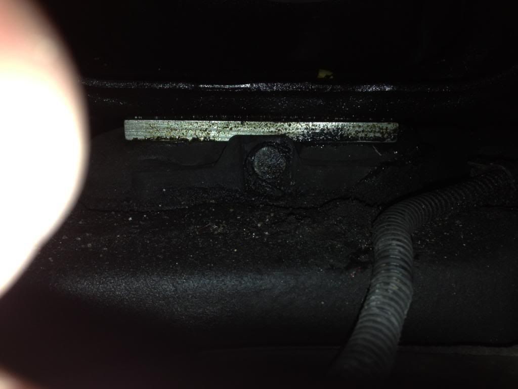

So the second thing I have in mind is what you see in the fourth picture, this what I am stuck on at the moment but will be replacing this on my day off tomorrow. The Lower motor mount. As you can see in the picture I do have a tranny and engine spacers for when my car was lowered to reduce the shake from going lower. I DO NOT have the lowering springs in the car anymore. I took them out cause every bump I hit on the highway made me pogo my way to work, and I felt it was only a matter of time before my struts go bye bye, so I put the stock springs back in. The motor mount feels squishy and is covered in grease down there as you can see it the picture couldn't tell if it was sheared though...

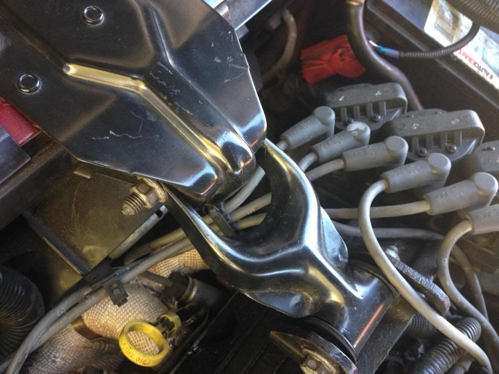

Picture 5 is the short dog bones I put on my car for lowering it. (sorry picture is upside down)

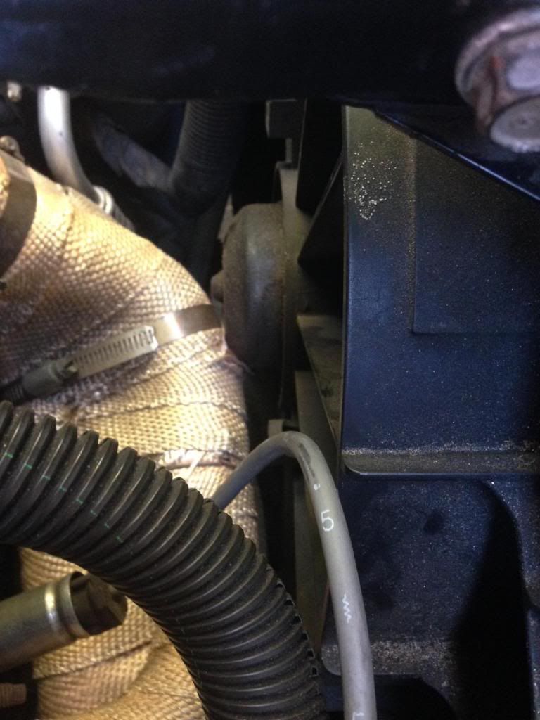

picture 6 is showing what the dog bone is doing, It's pulling the motor so far forward that headers on my car is touching the fans in the front of my car. Could this possibly cause acceleration shake? I believe I have to stock dog bones.

UPDATE: I replaced the LOWER MOUNT after work tonight and literally just got done test driving it at 330am :( . NOTE TO SELF AND EVERYONE ELSE: DO NOT try to replace a lower motor mount by your self. It took from 11-3am pretty much by myself trying to get the threads to line up on the bracket. FUCK that. :roll: have someone help you lol. now after I did this lower mount the shake is literally just about gone! I still feel a tad bit at acceleration and I can now notice the vibration from my shitty tires on it currently. once I replace tires on it the very dull constant vibration should be gone.now I think maybe the last bit of acceleration shaking could be that I didnt change out the tranny mount. and the fact I still got the short dog bones on the car. I think im just gunna go ahead and replace the tranny mount. I made it through doing the lower motor mount I think I can managed to do the tranny one, which I was told is easier anyway.

I would think you should go back to stock dog bones. No reason to keep the wires so close to the fans etc.
It sounds like you are already on the right track towards fixing your problems. Keep the engine and transmission held in place, then look for further problems...
If you don't have the lowering springs anymore, I'd think you want to get the shims out of there too.
